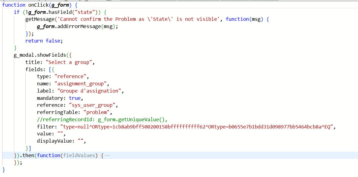

I'm trying to implement something very similar (an assignment group picker in modal).
The field displaus correctly on my modal, if I pass it a value from g_form, I get a preview from the correct group, but I can't quite get the dropdown to load other groups to select.
Here's a screenshot of my current code and the result I get.
I'd be very grateful if you have any indication on what I'm doing wrong.
