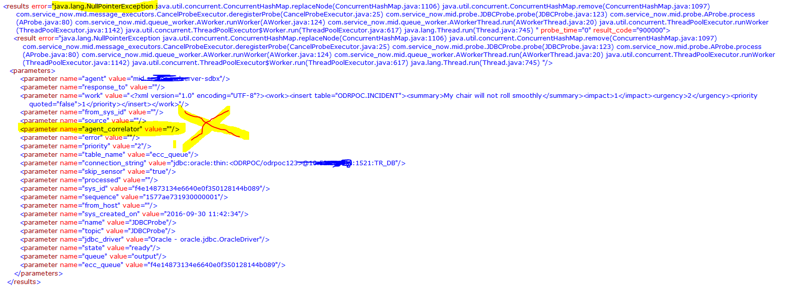

Hi Team,
I am getting this below error in response entry in the ecc_queue via mid server during insert operation via JDBC Prod. Could you please suggest what to do. I am unable to access the hi article on the same which is mentioned in the other post related to this issue, can some one suggest how to fix this or post the content of the hi support article related to this.

Hi Tony,
I tried as per the HI Article it is stating below and i did so but still i can see agent corelator giving null.
The agent_correlator is a new requirement for ecc_queue records in Geneva. This field associates outbound requests with the resulting response record in the ECC queue. This issue occurs because the JDBC Probe that is created via the script include is not providing a value for the agent_correlator field. Therefore, when the MID server processes the response to the JDBCProbe, it fails to find a value and throws a null pointer exception.

var j = new JDBCProbe("midserver-sdbx");
j.setDriver("Oracle - oracle.jdbc.OracleDriver");
j.setConnectionString("jdbc:oracle:thin:<OD/odr3223123>@10.52.206.19:1521:TR_DB");
j.setTable("ODRP.INCIDENT");
j.setFunction("insert");
j.addField("summary", "My chair will not roll smoothly");
j.addNumberField("priority", 1);
j.addField("urgency", "2");
j.addField("impact", "1");
j.create();
Result in the input response in the JDBC PROB under queue.
I also twiked and used the below code from snow but still it is not generating the agent_correlator value.
obj.agent_correlator=obj.addParameter('agent_correlator',gs.generateGUID());
Can some one advise.
