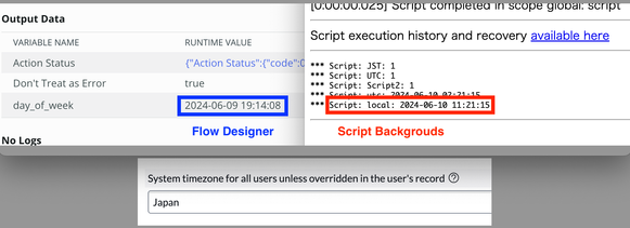

I found that GlideDateTime.getDisplayValue gives different results between Flow Designer and Script Background.
Our time zone is Japan.
The script running the attached image is the same.
I need help because I don't know the cause.
var gdt = new GlideDateTime();
var local = gdt.getValue();

The attached photo is the result of getDisplayValue().(Local time is JST)
var local = gdt.getDisplayValue();

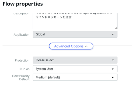

>flow is running with system user?
Yes, I am running as System User.

I would like to create a batch process using Flow Designer that only runs on weekdays.
Flow Designer retrieves incorrect values.
I can get the correct values when I run the same Script in Script Background.
