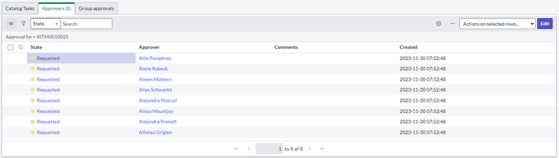

Also, as another example (I hope this is a better example), I will paste here what we are looking for. Imagine that an RITM has 3 groups of approvals: Group A has 3 approvers (Allie Pumphrey, Alene Rabeck and Aileen Mottern), Group B has 4 approvers (Allan Schwantd, Alejandro Mascall, Alissa Mountjoy and Alejandra Prennatt) and Group C has only 1 approver (Alfonso Griglen). The situation at this moment would look like this:

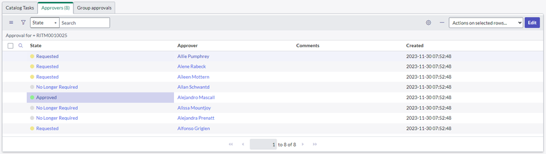

If Alejandro Mascall approves his approval (from Group B), the situation would look like this:

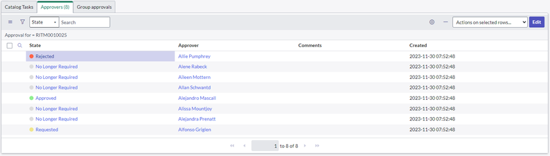

Now, if Allie rejects her approval, the Group A would change to this:

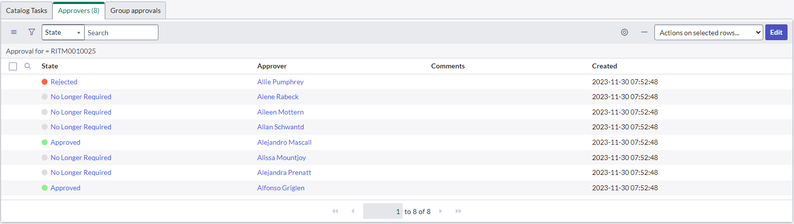

Finally, Alfonso (at Group C) can also approve his approval, and the list would end like this:

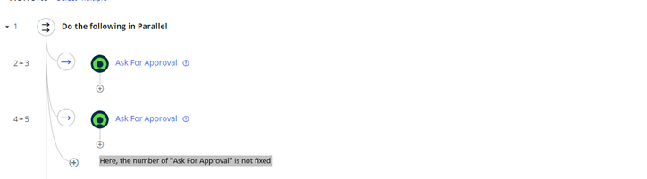

Also, I need the groups to be dynamic (there will be different number of approval groups every time) and every approval group will have different number of approvers every time (for example, sometimes it can be just one approver, sometimes it can be 10), and the way it is set in Flow Designer seems to allow me only a given number of approval groups at the designing time.

Based on your further details, if you put each group approval in its own "ask for approval", then you should only mark the same group as "no longer required" and not impact the other approvals. To have the approvals dynamic, I wonder if you could identify all the groups before assigning, then use a while loop to trigger an approval for each. What I don't know is if you can have it assign them all and then only wait for decisions after they're all assigned.
