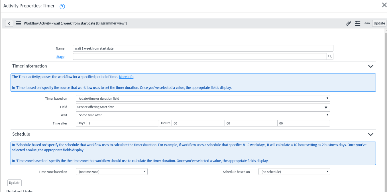

Can someone help me with a script that will create a task in 1 week from the start date?
So for an onboarding request HR will enter a start date.  I want a task created in 1 week from that start date on the catalog item.
Here is my workflow
This is what's in my timer.  But when I ran my test it creates the 1 week follow up task.

The timer activity is based on seconds when scripting.  There are 86400 seconds in a day.  So multiply that by 7 days and you get 604800.
So in your timer activity change the "Timer Based On:" field to "Script" and then use the following script:
answer = 604800;
That's in seconds...so you can always test it by putting 120 in there and see if it waits 2 minutes before creating your 1 week task.
