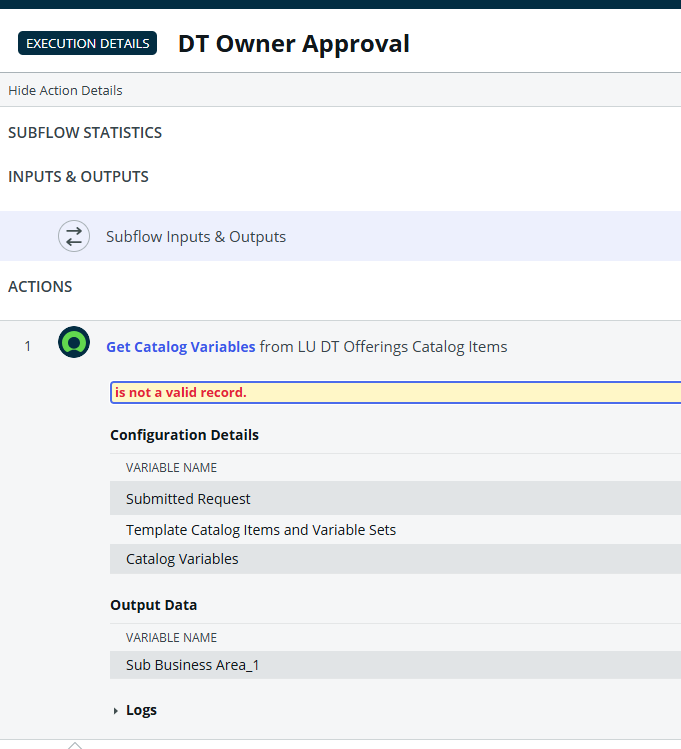

In my main flow, I try to wire things up in this order:
  1. Call the action Get LU DT Catalog Variables Action
  2. Then call the subflow Get LU DT Catalog Variables
  3. Then call the subflow DT Owner Approval
At runtime, when I pass the sub_business_area (or its sys_id) as the reference input for the DT Owner Approval subflow, I get the following error: "is not a valid record" as well in the log: "Encountered error executing instruction: ActionErrorEvalInstruction{id=4, conditions=[], statusKey=c1o.__action_status__, dontTreatAsErrorKey=c1o.__dont_treat_as_error__}, errorMessage: is not a valid record., errorCode:1"
and: "com.snc.process_flow.exception.OpException: is not a valid record"
Because the flow stops at the DT Owner Approval step, I have not even been able to test the task creation logic yet.
Is there a better way to pass the sub_business_area variable from the RITM so I can identify the correct LU DT Offering in the approval subflow?
Is the architecture of linking requested_item with LU DT Offering based on the sub_business_area even correct?
Also, I am not sure if this entire design (Catalog Variables + subflows + Workflow to create tasks) is the best pattern — I’d be very open to suggestions for a better approach.
Finally, when adding the DT Owner Approval subflow to the main flow, I’m not confident about populating the inputs correctly (especially reference fields vs sys_id).
