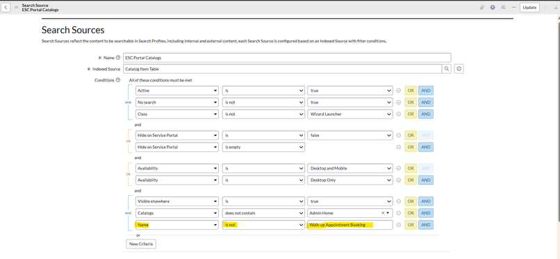

Hello @curr_user ,
Since the record producer is protected and can’t be edited directly, you can hide it from the ESC portal by adjusting the search source. Here's how you can do it:
Steps:
Go to Filter Navigator → AI Search → Search Experience → Search Sources
Open the search source for ESC Portal Catalogs
In the conditions, add a filter to exclude the OOB item by name — for example:
Name is not "Walk-up Appointment Booking"
👉 Note: If you decide to create a separate search source instead of editing the existing one, you’ll also need to update the search profile accordingly to include the new source.
You can refer to this doc for more details: 🔗Create a search source
After saving the changes, try clearing your browser cache or logging out and logging back in. In some cases, changes don’t reflect immediately without a refresh or cache clear.
Once done, search again for “Walk-up Appointment Booking” on the ESC portal. It should no longer appear. I tested this in my instance and it worked as expected.

Hello @curr_user ,
Steps:
Let me know if it works for you or if you run into any issues!

06-29-2025 08:20 AM
Hello @AniketC85155510 ,
We tried what you suggested above. Although, it did not work by adding the condition 'Name is not "Walk-up Appointment Booking"', but it worked using the 'Short Description is not "Book walk-up appointment"'.
We could not debug as to why it was not working with previous filter but got the solution though.
Thank you for solving the issue.
