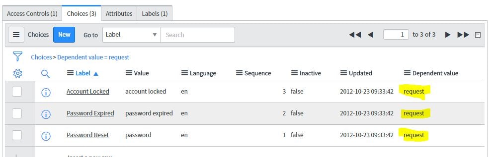

You can have both the options. Find the screenshots below:
1. Different choices with same dependent value.
2. Same choice with different dependent value.

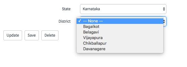

Everyone else is correct. So here are some visual aids
1) Create 2 Choice fields, State and District

7) Go back to the form and select the first state in the State field. Then right-click on the label of the District field and select Configure Choices
😎 Populate the Districts for this State. Once complete, go back to the form and select the next state and repeat.
9) Now when you select a State, the values in District will update automatically.
