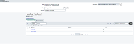

I will share the results soon once I figure out one issue. Basically, when I removed the Comments/Worknotes record (screenshot below), the Compose section was also deleted from the workspace view, but I want to keep it
Compose section that also was deleted

It seems like the Compose section is an integral part of the Comments/Worknotes sections in the workspace view. Therefore, if I remove any of the fields (comments/work notes) from the workspace view, they won't be available in the Compose section either.
I kept only worknotes, and comments were deleted from the workspace view.
This means I need to go with a UI Policy, as only this solution works --> Comments/Worknotes section is hidden, and the Compose section is visible.
