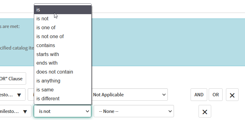

I have a requirement to hide a field if another field that is a list box is set to "Not Applicable".  I have been able to accomplish that with a UI policy that applies to the Variable Set that contains both variables.
My question is, how can also hide the field if nothing has been selected and "None" shows in the list box.  Please see the images below for the UI policy configuration.
Because your UI Policy actions are to show the field, you'd have to use "AND", instead of "OR" if you're going to use IS NOT.
So condition one is "Not Applicable" AND condition two is not "-- None --", then...do 'x'.
So it'll only do 'x' when both are true, which is what you want.

There should be a condition for "is empty", you can use that as well.
So condition one AND condition two, since you're showing the field.

Is empty is not one of the condition and I have tried is not None previously  and that does not seem to work.
