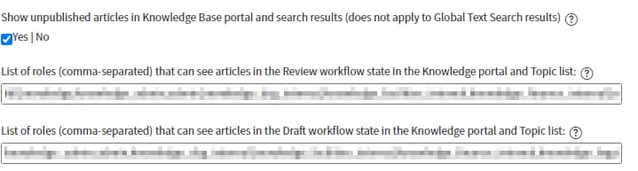

The business has asked if it is possible to hide unpublished knowledge articles on the Service Portal for users but not affect the back end client search. The requirement is so that users have the same experience as customers do when using the portal,
I understand the following setting within properties, but unticking this option will not allow users to search related articles within incidents etc.
