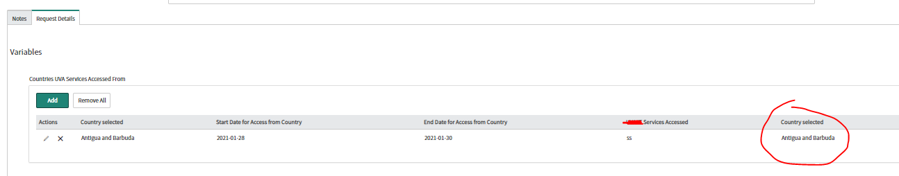

I have a Multi-row variable set which I am using in a catalog item , how to hide a variable on that , I am not able to hide the Variable Using UI policy as the visible is grayed out
I also created a onload cS still not working

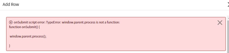

So bascially I created an onload client script which apply on task , ritm and item and Isolate script to false ( unchecked) with the above script by placing my MRVS sys_id
created onload client script on MRVS as shown in the image above (please let me know If i call the function properly ?
and On submit on my MRVS as the code provided by you.
I created all the 3 but still see the variable on RITM
01-28-2021 07:01 AM
Seems like you're setup the same way I am, but experiencing different results. Does it hide the value when you are first submitting the request?
It seemed to hide the same both when creating a request and when viewing after submission (on the RITM), in my instance anyway.
Maybe add an alert to the process() function and see if / when it is actually being called?
01-28-2021 08:28 AM
I see the alert when i try to create the request ( when I open the catalog item ) after adding the details and click on add to cart ( alert popup ) and cannot see the duplicate variable
after creating the Request it is not alerting and can see the duplicate variable
seems like it is not passing to RITM level ( I check the RITM check box in client script )
