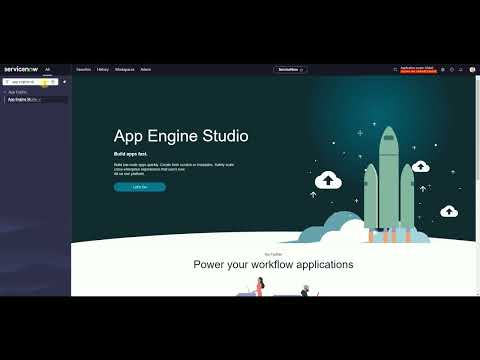

Hi Sean. You need to check this playlist out on YT https://www.youtube.com/watch?v=rG8yXWN8ouA&list=PLDLTlm2deb9tbyuQ5ul5OIleUWT3EZFKo
It isn't easy to do but if you follow Jan's videos, it is doable. I got it working yesterday.
Two points that Jan doesn't mention though. He is using SNUtils which makes editing the fields and finding sys_ids easier, so make sure you have that installed. Also, I had to installed the CSM module so I could copy the records Jan refers to. I tried to do it using the SOW records, but failed. CSM plugin takes about an hour to install and is free on a non-prod instance.
