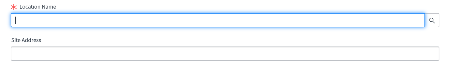

I have a variable on a catalog item, 'location_name_ref', that is a reference to the cmn_location table. I have a single line text variable, 'site_address'. I believe an onChange script is needed to pull the 'street', 'city', 'state', 'zip' label display values from the 'location_name_ref' selection to the 'site_address' variable, but I'm not sure what that code looks like. We have something similar from a previous employee that pulls a user's email from a different reference variable to a single line text variable:

For clarity, I would like to select ABC as the referenced location and have it auto populate the street, city, state, and zip from that location in another variable.
