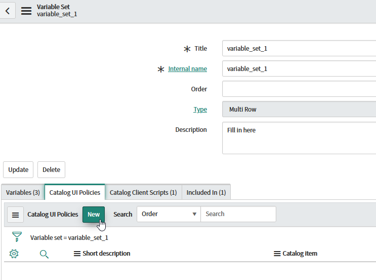

While I love UI Policies, using Run Scripts is a bit complicated here as you'd still need something to key off of in the condition builder.
Create an onLoad Catalog Client Script that only runs in the Mobile/Service Portal UI Type, and put in g_form.setReadOnly('your_var_name',true); This should set the variable Read Only, only within those UI Types and not Desktop.
‎09-01-2020 08:06 AM
Seems like it is Single Line Variable you used.in Variables of catalog Item you can Set the Default
Value as 'XYZ' for City Variable.
You can use the UI policy for Catalog Item give the condition 'is not empty' and apply as Read Only.
