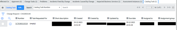

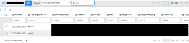

1. How can I pull the list of all catalog task records to a custom table (m2m*****) from main sc_task table ?
     The inputs created in the custom table as show in screenshot is manual entry as of now.

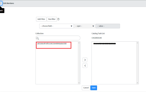

2. This custom table is being used as a related list under change request form, when clicked on 'Edit' for this related list I am getting the sys_id of the catalog tasks listed in the custom table. How to resolve this ?
The collection should show the SCTASK by number but it is showing as sys_id how to fix this ??

Hi @Arunima_12 ,
The answer to your 2nd question is :
Go to ur custom table & right click on any column select configure- table.
Once the table opens set the number field Display value to true & update it. This can be performed from the list view itself. Once done u will be able to see number instead of sys I'd.

Hi @Arunima_12 ,
For 1st case u should have extended ur custom table with task table do that it could contain all the existing task values along with the manually created ones.
Danish
Thanks Danish, the solution for 2nd question is helpful and fixed now.
