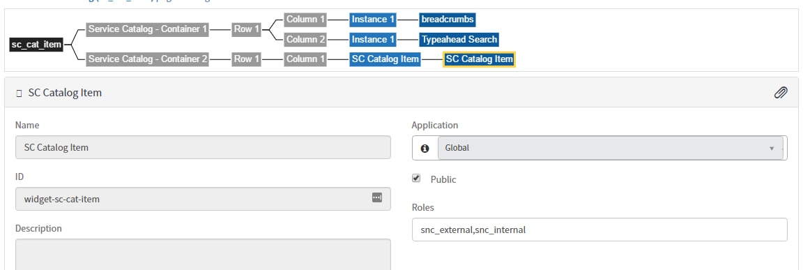

This is linking to the sc_request page to open the Create Facilities Request record producer.   I have set both sc_request and the SC Catalog Item widget on that page to be publicly accessible (see below).
I have been able to successfully configure the portal to the point where I can access the request as guest, but when I try to submit the request it fails.   No errors... it just sits and spins.

John,
That is because record producers are not available to unauthenticated users. Behind the scenes they are calling in to "angular.do" which requires authenticated user so with the current implementation... it is not going to work when public. Now that being said, we are working on our own implementation of this widget which will use Oauth and REST to handle the submission which should work for public users.
