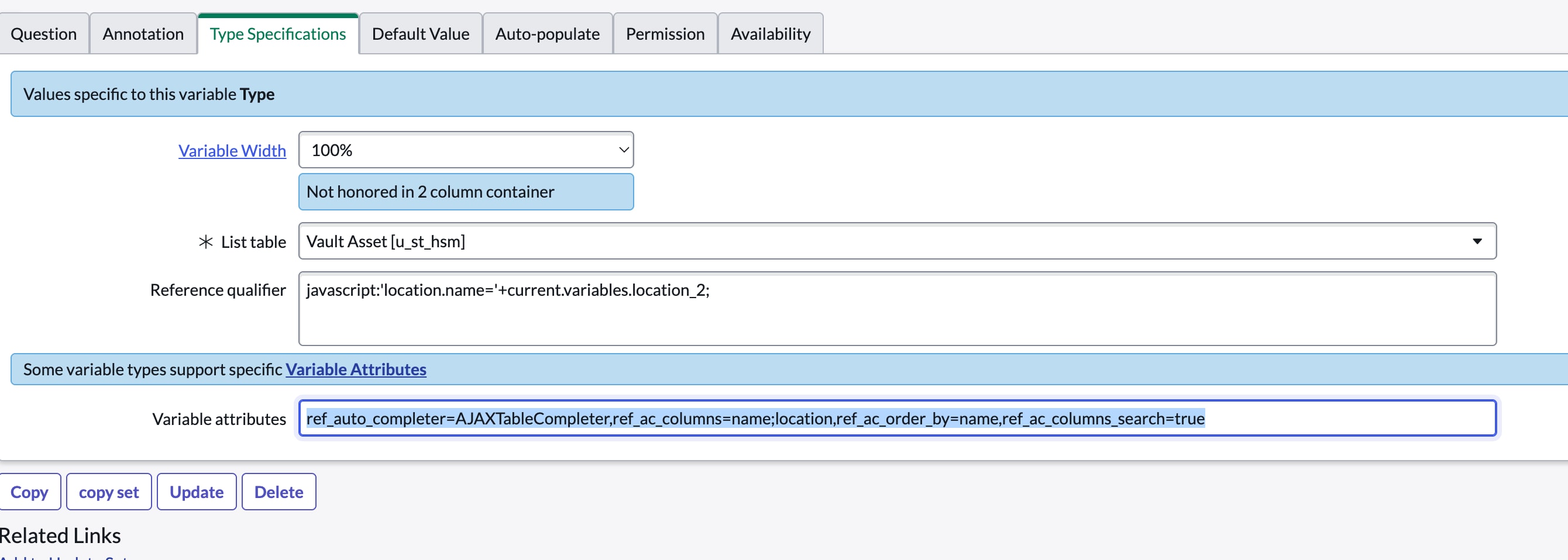

I have a list collector field in catalog item which is referencing the asset table called u_st_hsm. I have to populate fields on the list collector based on another variable in the catalog item called location_2 . I also need to add another filter for the list collector to display values which have install_status.value!=3 or Install_status is not In Maintenance. How can we add reference qualifier for this.
the current reference qualifier is
javascript:'location.name='+current.variables.location_2;
variables attributes is
ref_auto_completer=AJAXTableCompleter,ref_ac_columns=name;location,ref_ac_order_by=name,ref_ac_columns_search=true
I need to add filter on the list collector for asset table so that they do not display values with Install_status which have value 3 or In maintenance.

If your current reference qualifier is working for the first part, the new one would look more like this, assuming your instance has the out of box value of 3 for 'In Maintenance':
javascript:'location.name=' + current.variables.location_2 + '^install_status!=3';
If your location_2 variable is a reference type, then you would just use 'location=' as reference variables store a sys_id and location is a reference field on the asset table so that would match the value stored in location_2.
Since this is a List Collector variable, your Variable Attributes aren't appropriate or relevant as they only apply to Reference type variables and fields. You do need one new attribute so that the list filter updates when the value of the location_2 variable changes:
ref_qual_elements=location_2

Try the below reference qualifier
javascript:'location.name='+current.variables.location_2+'^install_status!=3';

09-10-2025 08:21 AM
Hi Nehal,
Thanks for your help.
We tried this and it seemed to work.

what should we include in the variable attributes.
the current variables attributes is-
