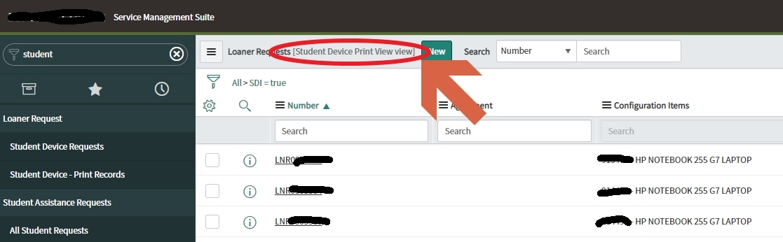

Our list view, triggered from application menu "Student Device - Print Records" is using a specific list view.
"Student Device Print View/"
When I drill into a record, I want to see the corresponding form layout view.
Depending on what the user last used, we get the incorrect view.  User has to click on the hamburger, and switch back to "Student Device Print View."find_real_file.png
Is there a way to force the list view to show a specific view rather than the user's last default view?

dmullinax
Mega Guru
A view rule is not going to work for me.  In order for it to work, it has to be based on a condition.
For example, I set this field "SDI" to true.
You'll see it is inactive because I've already tried this.
I do not see how I can define a view rule based on what application menu the user clicked on.
So... I that field is true, that form view will always evaluate to true preventing the ability to see the other view.
How does this know what list view you clicked on?
Ankur I tried setting the argument in module "&sysparm_view_forced=true&sysparm_view=student_device_print_view."
This did not work.
