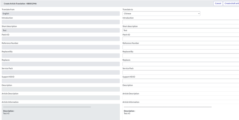

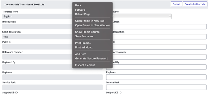

I am trying to figure out where to modify the side-by-side translation view on a translation task. The view has some fields I would like to remove and reorder. I tried right-clicking the top banner, and nothing happened, so I cannot configure the layout. How can I change the view of this form?

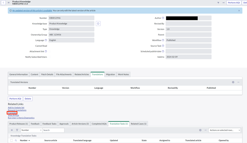

You can get to it by going to a knowledge article and clicking the "translate" UI Action in the related links. The UI Action appears to redirect to the kb_create_translations table. I have also included the associated docs of how to open a translation in translation management below.
Screenshot of knowledge article:
Screenshot of translation task side-by-side view:

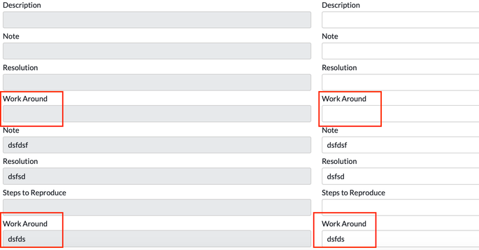

The primary use case is to provide translation users with an intuitive UI. Right now duplicate fields are showing on the form, such as short description, description, and workaround fields. If one of the duplicate fields is updated and the other is not, it will only take the value of the first field. This shows a problem since values are only filled in one of the fields from the translation module (see screenshot below). I am trying to update the layout so I can remove those fields. Do you know where I may be able to change the layout of this form?
Duplicate fields on translation side-by-side:
I tried right-clicking on the top banner, and it does not let me change the layout.

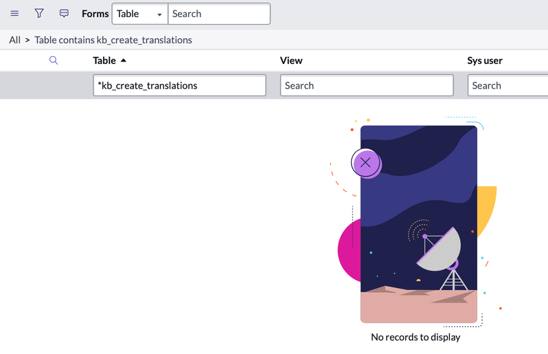

I also checked the Form table (sys_ui_form), and there are also no forms for the table:
