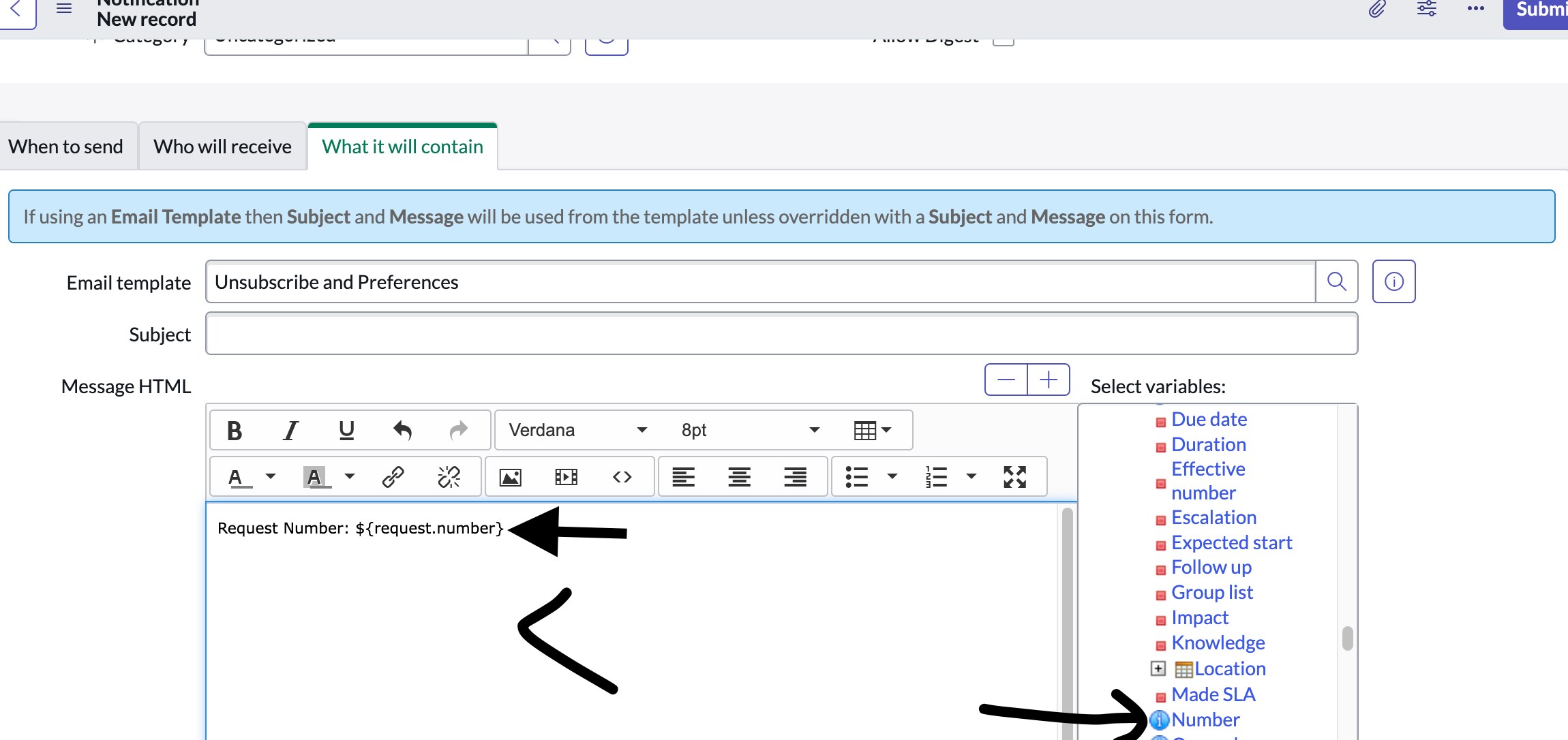

Mohith Devatte
Tera Sage
hello,
you can access it via fields in the what to contain tab
Example: my NOTIFICATION is on RITM table and i wanted to print my request number so in the right side panel i can expand request field and select the number.
After clicking it printed ${request.number} so i will copy this to my subject and the request number will be printed.
So in your case follow the same process find the incident field and expand it and select number or
get to know your back end name of incident field and do .number like below in subject
Subject: Incident number : ${incident_field_backend_name.number}
Please mark my answer correct if it helps you
