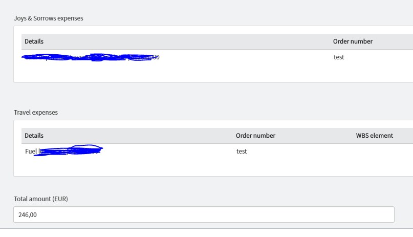

09-13-2019 10:21 AM
Yes indeed. You can't add a seperate floating variable just for the sum on the MRVS. So a workaround would be to have a Total variable outside your MRVS.
After submitting your Catalog Item, it would show something like:
Kind regards,
Mark
