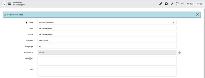

Hi @kim-lindgren,
You need to right click on Description field on Incident form. Select Configure dictionary.
In related lists, crate a new record for Incident table with below details. It will update label only for Incident table.
If my response helps to solve your issue. Kindly mark it as helpful & correct. It will be helpful for future readers.

Clicking Configure dictionary and going to the Labels related list to create a new label specifically for the Incident form has solved the issue. Thank you.
