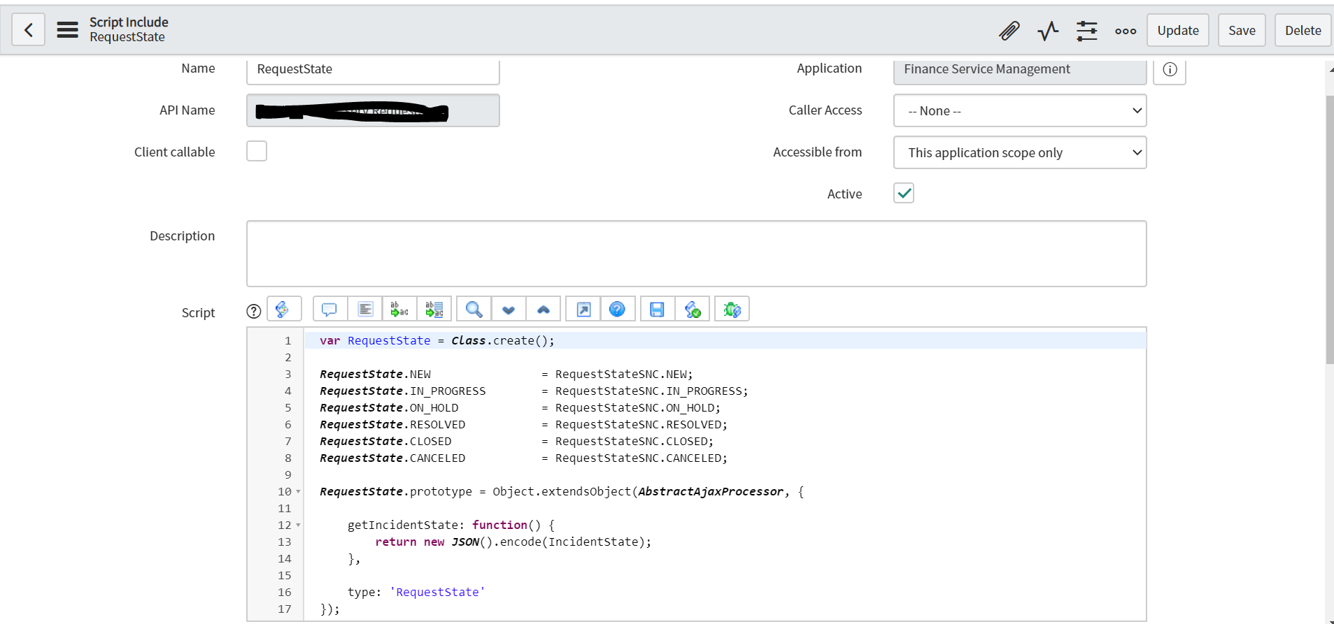

Hello CB,
I have created State model which is showing fine there is no issue and coming script include please find below image and help me if I have made any mistakes in this
Chaitanya
Hi Chaitanya,
This is just the states definition. Have you define any state model or state transition or state flows.
Like from which state it should go to which state.
like we have for change state model.
Thansk,
Cb
