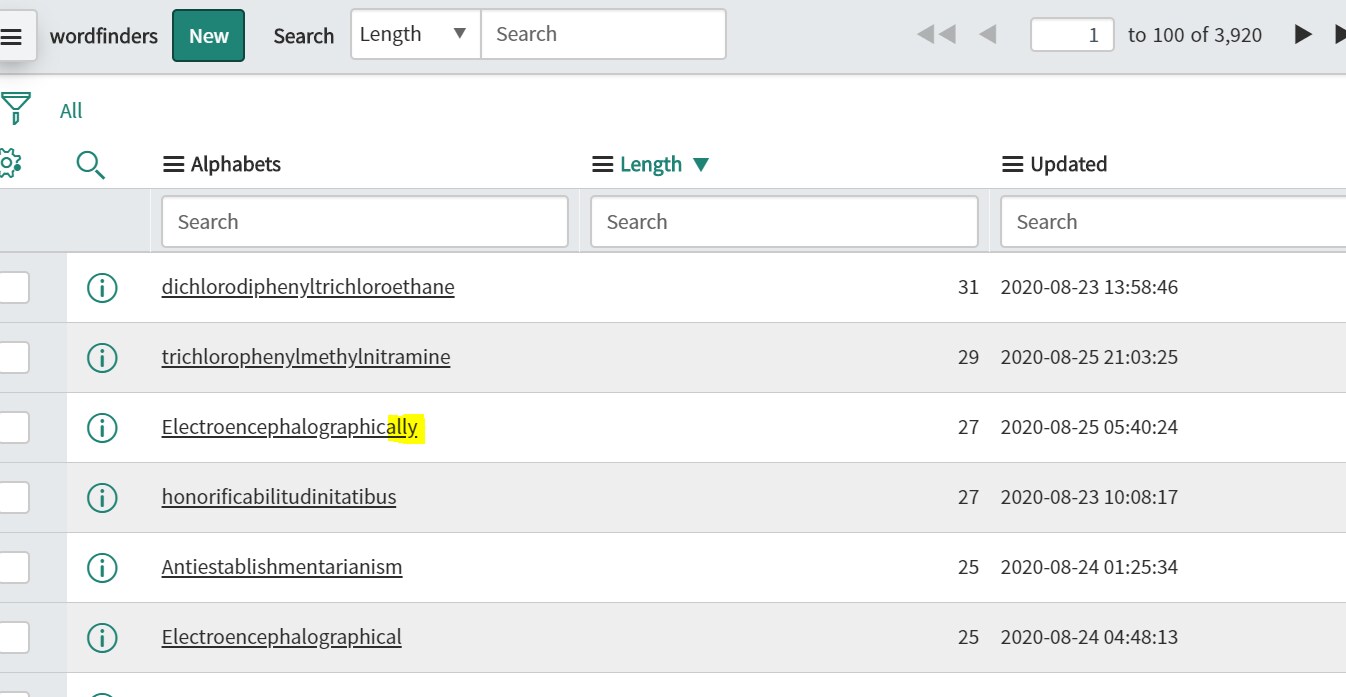

Hello Team,
I have a requirement to change the background colour field based on given condition.
As I highlighted above, If a word ends with ly , I want to show that column color as some green or red anything,
How to achieve this??

you can use the Modern Cell Coloring option
uncheck that option from gear icon
apply style like this
1) left nav type field styles
2) create new
3) give your table
4) Select the field name
5) Value - give proper field name here
javascript: current.alphabets.endsWith('ly')
6) style - color: green

08-26-2020 12:05 AM
That's awesome. Thanks much

10-31-2022 07:43 AM
@Ankur Bawiskar, how i use this rule, but condition other filed ? For ex, change back field Lenght, with same condition (javascript: current.alphabets.endsWith('ly')) ?
