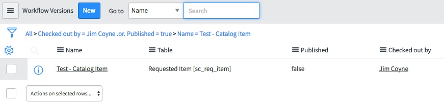

You can't change it on the form if the Workflow is already set to a couple special tables like Requested Item or SLA, but you can change it behind the scenes. Use the "Workflow Versions" Module to filter down the list and display the new Workflow you've copied:
You can use one of these tools to help you generate the proper GlideRecord script to update it:

You'll end up with a script similar to this:
(function() {
var gr = new GlideRecord('wf_workflow_version');
gr.addEncodedQuery('checked_out_by=javascript:gs.getUserID()^ORpublished=true^name=Test - Catalog Item')
//gr.setLimit(100);
//gr.setWorkflow(false);
//gr.autoSysFields(false);
gr.query();
while (gr.next()) {
gr.table = "incident"; //or whatever table you need
gr.update();
Just add lines 9 and 10 to update the table name and you should be good to go. You can run the script in the Background Scripts page or James.Neale's excellent Xplore tool.
