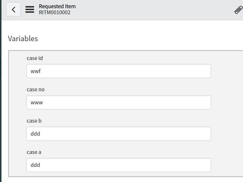

whenever an RITM is created i need to create a record in my custom table ("CASE FILING ");
how to achieve this using Business rule.
Here RITM is getting created with 4 variables , with the values of these variables i must able to create a record in case filing table . how to achieve this
how to automate this whenever an RITM is created it should automatticaly create a record in my case filing table?
