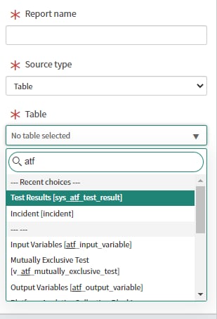

05-30-2021 12:10 AM
Hi Alice,
You may have added that table at wrong place so that is not visible in reports. Add it at correct position in UI Properties:-
Once you will add and save it- navigate to report >> Create New and you will find these tables [For test Suite results and Test results] there and you can select the table as per your requirement.
