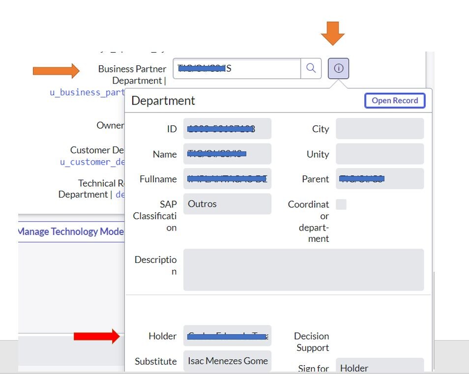

In order for me to be able to get the value of the "email" field, I initialize it using the form in the first
table (cmdb_cit_business) then I need to do a dot walk, in two different tables, because the field is a reference (Business Parnet Department) PRINT_1:
Within this field there is another table (cmn_department) where there is the "Holder" field (which is also a reference field) PRINT_2
In turn, there is another table (sys_user), this will have the email field, which I need to get the value of. PRINT_3
I tried to do it this way, but it's not working, does anyone have any suggestions?

Dibyaratnam
Here i have taken example of incident table.
It has Configuration item Reference field. then the table contains a Owned by field, which refers to sys_user table where the Mail field is present.
Check the below script to find mail .
var grCmdbInc = new GlideRecord('incident');
grCmdbInc.addEncodedQuery('cmdb_ciISNOTEMPTY^active=true^sys_id='+recordsysId);
grCmdbInc.query();
while (grCmdbInc.next()){
    if(grCmdbInc.cmdb_ci.owned_by&&grCmdbInc.cmdb_ci.owned_by.email){
        gs.info(grCmdbInc.cmdb_ci.owned_by.email);
Make the changes as per your requirement and you should be able to get the data.
Just to point out, in your script, in while loop, you have written gr.next(), instead of grCmdb.next()
Please mark as correct if it helps.

Hi @Dibyaratnam !
I intend to use this script within the Schedule Report (PRINT_1), as a notification
must be sent to the Group Holder’s email.
Because of this, I thought about the possibility of doing the GR and accessing the email via dot walk.
Note: I just don't understand "sys_id='+recordsysId", when I use it in the background script (PRINT_2)
it doesn't work, when I remove it it only brings up a specific email several times, even though I include it
grCmdbInc.setLimit(1);
Note: I did the test with INC, to see if it worked, then I will make the necessary changes.
Thank you very much for your feedback and attention, I am very grateful!
