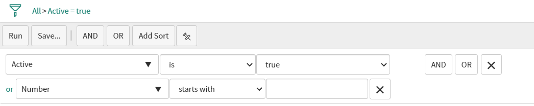

Its good like i am getting the filter visible. But i am not able to change my filter. If i click "All then it disappears. I wants to use filter as same as we will use in UI side. Like query builder we can filter anything.Like this
I don't want static filter .I would like to use dynamic filter option with query builder. Exactly same as above image. Suppose if i wants to change the filter i would like to change and see the records in the service portal page itself. I hope its clear.

08-10-2020 06:20 AM
You need to pass enable_filter to true to make it possible.
