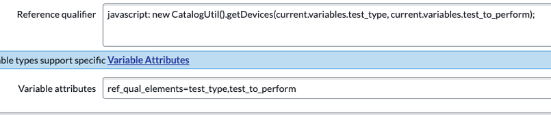

If you truly have a List Collector, not a List, then you must be referring to variables on a Catalog Item, not fields on a table. This distinction is important in this case as the solution depends on it. So when Scenario A is populated for the first variable, and Test D is populated for the second variable, does the 'hardcoded' mapping already exist anywhere? If it's the value of a system property, or only exists in how you want the available devices to be filtered, the List Collector reference qualifier needs to call a Script Include, passing in the value of the the first two variables, something like this:
where test_type and test_to_perform are the variable names for the first two. The Variable attributes ensures that the list filter is updated when either of the two other variables is updated.
The Script Include (named CatalogUtil in this example) will contain a function(named getDevices in this example) which will execute a GlideRecord on the Device table with addQuery lines within if statements so that it returns only the records that match the mapping. For each record returned, push the sys_id to an array, then the joined array is returned like this:
return 'sys_idIN' + devArr.join(',');
where devArr is the name of the array you pushed each sys_id to.
You may need to add the asset_id field to the display or list view, depending again if this is a List type field or a List Collector, and if so if you are using this in Service Portal /ESC, and/or using the glide_list attribute to make it display like a list field instead of the Available and Selected boxes.

The reference qualifier will be similar, passing current.field_name to the Script Include, instead of current.variables.variable_name. The attribute is the same, or may not be needed on a List field.
