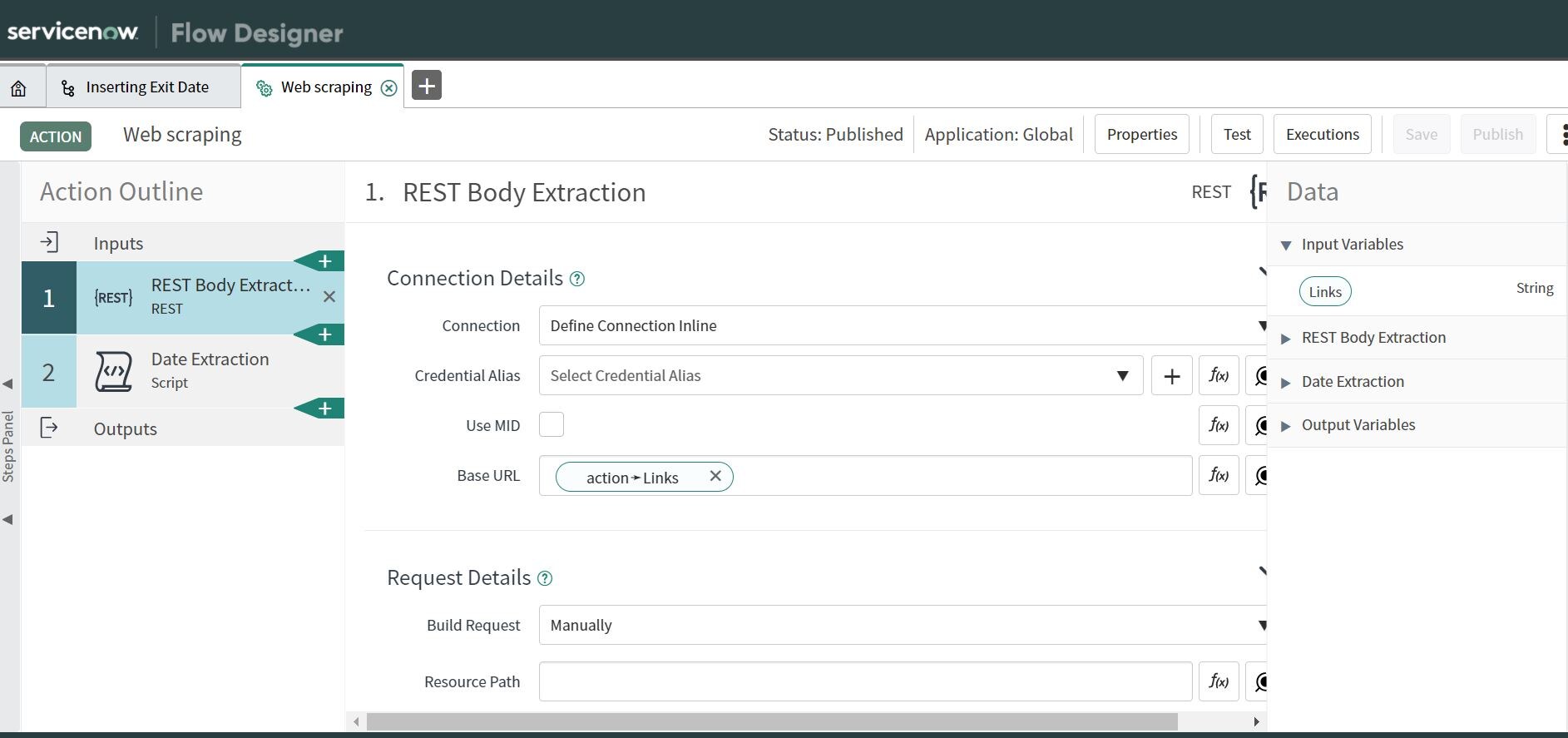

I have an action in flow designer which accepts links as inputs to extract certain details.
This used to work fine until a week ago and no changes have been made to the action in anyway, but now when it runs the following error is shown:
Request not sent to uri= https://web.sba.gov/pro-net/search/dsp_profile.cfm?requesttimeout=60&duns=125132048 : org.apache.commons.httpclient.HttpException: javax.net.ssl.SSLPeerUnverifiedException: peer not authenticated
The link provided as input for the REST call for that particular case was:
The image attached to this post shows the REST Body used. The particular link is passed as Base URL.
Can someone please help me with this issue?
Thank you so much in advance!

My issues was with the website that I was passing, it had certain outdated HTTP functionalities. Once it was updated by the website owners the problem was fixed automatically.
