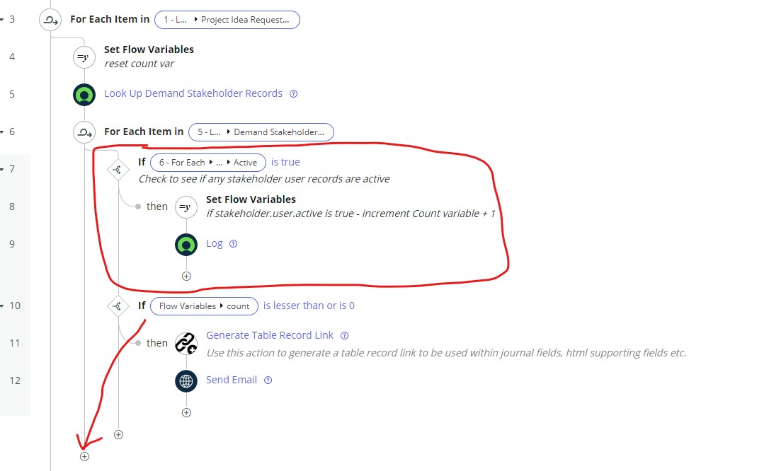

Hey @Zach Koch,
Wanted to pick your brain on this issue:
I have the flow finalized and it's working as intended except I can see a potential issue (see screenshot)
Essentially I have a nested For Each cycling through the Stakeholder Records for a given Demand Record. I want to see if any of the Stakeholder user records are active, if not, then send an email and inform them.
The issue I'm seeing here (circled in the screenshot) is that I think I'd need this If statement check to fully run against all the Stakeholders before hitting the second IF which sends out the email.
Otherwise I could see a scenario where the very first Stakeholder record has an inactive user, so it would send an email. However maybe there's a second Stakeholder record tied to that Demand and therefore shouldn't be an issue.
I feel that maybe the second IF should be moved outside the For Each in some way but not 100% (see arrow in screenshot)
Just curious on your thoughts regarding this.
Yes I would recommend moving your second If statement to where you have indicated on the arrow. This will ensure that ALL stakeholders on the record are checked for active before the notification goes out. As you have it now you are correct, it could send it out if the first one was inactive, but the second one was active.

Hey @Zach Koch,
Modified the workflow and it's working perfectly. Greatly appreciate your help on this. I've accepted your original post as the solution since it resolved the initial issue.
