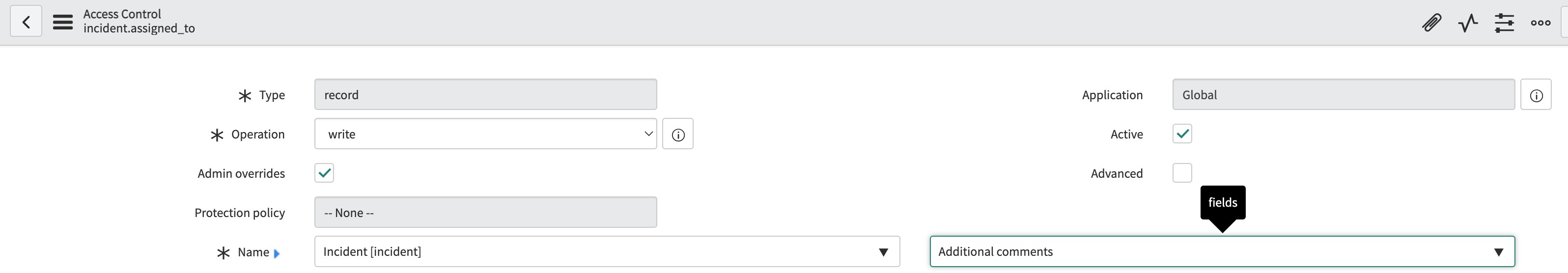

I have one requirement like need to give a access to particular Group in particular one field. I was tried but it's not working if i am doing. wrong please correct me
I have one Script but it's not working
if(gs.isMemberOf('GROUP A')){
answer = true;
}else
answer = false;
For example i have a one group that group name is GROUP A, Now i need to give a access to GROUP A members to edit the comments field only remaining to show read only for that GROUP A members.

Hi @Deepika Ravindran ,
Create an ACL for create and Write and put this code there, that should work.
In the script, put the code like below:
if(gs.getUser().isMemberOf("your group NAME")){
	answer = true;
	gs.log(gs.getUser().isMemberOf("your group NAME"),"acl working now");
}else
		answer = false;
Sandeep
Are you selecting correct values in Name field?
Also code shouldbe 'gs.getUser().isMemberOf('GROUPA')'
