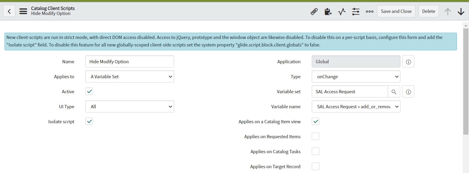

09-01-2020 12:00 PM
Thank you so much for responding. No the catalog item is being selected from the Service Portal. What other things do you need to know? See screenshot of client script as well as the client script:
if (isLoading || newValue != 'cat item 1' || 'cat item 2' || 'cat item 3') {
g_form.removeOption('modify');
else
g_form.addOption('modify');
return;
