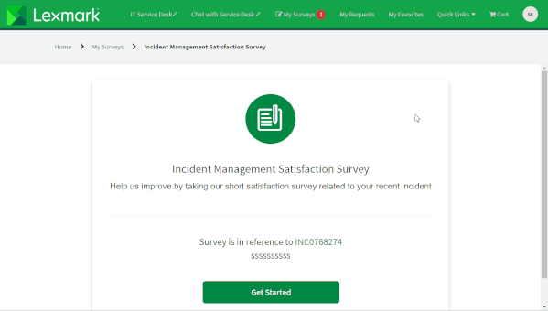

We want to do this same thing. I figured out how to add the ticket info to the top of the widget, but because the widget auto focuses on the first question, that info is not visible unless the user scrolls up. For that reason, we, too, would like to be able to modify the directive to insert this information after the title, just before the first question. I'm thinking through alternatives like displaying the ticket # and a link in the breadcrumbs or adding another widget above the survey widget that holds the ticket info. Our goal is for the survey taker to remember the ticket they're taking the survey for, in case they get distracted or don't fully recall the details.

Hi @Prabhjot Kaur4  Yes, we cloned the "Surveys and Assessments" widget (id = take_assessment) and added it to the "Take Assessment" page (id = take_assessment). I've attached our custom widget as XML.
