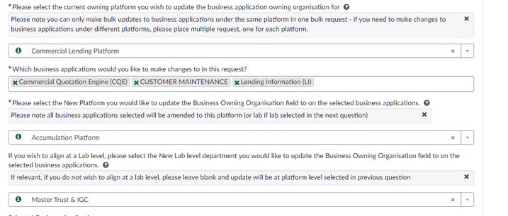

I'm the below catalogue item where users have to select their options:

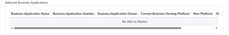

On the final part of my catalogue item, I have a multi row variable set where I'm wanting to add the selected details:
Does anyone know how I need to populate my multi row variable set with the selected options?

Hi @Ankur Bawiskar  That is correct. The requirement is to display list of selected business applications and confirm the platform or lab they will be transfering from and to (from the answers to questions above). Show Business Application Name, Bus app Number, Business Application Owner  and answers from original platform question (Q1) and New Platform or lab question (Q3 or if selected Q4) eg if user selected existing platform as 'Cloud' and new platform as 'Business Banking' show.
@matthew_hughes
so user will select business app from list collector variable and based on that you need to add information from that Business app into each row of MRVS?
you will have to ensure you create correct onchange client script on those required variables.
I will suggest to populate the MRVS after RITM is submitted rather than having multiple onChange client scripts
@Ankur BawiskarWould one way of triggering it be by having a checkbox as a variable, so that if it's checked, then populate the variables?
