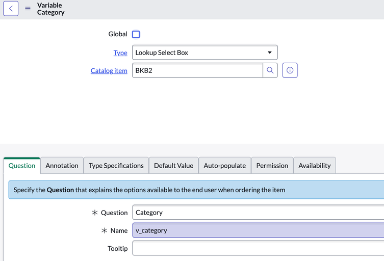

Hi Experts,
Please suggest how to proceed. Creating an RITM with a variable which should be 'Drop Down' and the values from drop down choices should come from sys_choice table , so that whenever we add or remove it should reflect accordingly.
Brad Bowman
Mega Patron

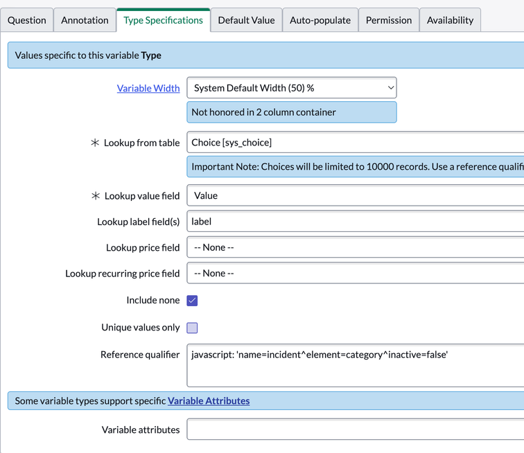

You can do this with a Lookup Select Box type of variable.  I have configured this example to emulated Category as seen on the Incident form / table
In the Reference qualifier, use the name and element from your desired choice list.
Brad Bowman
Mega Patron
Thanks @Brad Bowman  that gave a direction useful to proceed .
