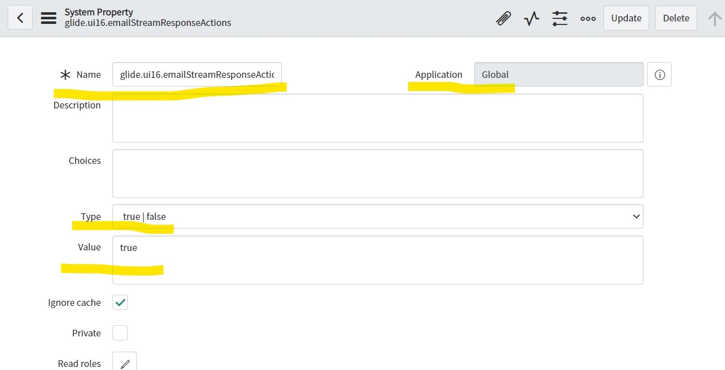

I have seen a post regarding property that enables Reply, Reply all and Forward buttons but I am not sure why the property is not working. Is there any alternate solution for this use case? Please help!
Ticket and mail: (Reply , Forward buttons not visible)
Property enabled:

I have done the same thing and I can see the buttons on incident form and problem form but not on case form. I have this doubt whether the property needs to be of string type or true/false type.  Please suggest.
(By default, the email_reply UI Macro is not active and I left it as is.)
Also, is there any possibility to make them appear only on CSM and not globally  unless there is a requirement to make it global?
It's a global change, and Yes, The system property type should be True/false. If my response is helpful you can mark it as correct and close the loop. It would help future readers as well.
