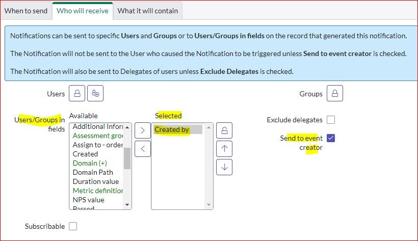

How to send a notification to created by instead of assigned to not provided. Can anyone help me on the email script?
Scripting and Coding
‎09-01-2022 02:15 AM
hello
we cannot set TO address from email script there are no OOB methods i guess.
we can only set CC and BCC.
One work around is we can use event mechanism to set the TO address
you can create a event in event registry table and write a script like below in a BR on release table with your conditions and it can be an after insert BR
if(current.assigned_to=="")
var gr = new GlideRecord('sys_user');
gr.addQuery('user_name',current.sys_created_by);
gr.query();
if(gr.next())
gs.eventQueue('your_event_name',current,gr.sys_id,'');
else
gs.eventQueue('your_event_name',current,current.assigned_to,'');
And in your notification change the trigger condition to event and give your event name so that when this event fires it sends the notification.
Also you need to check Recipient contains parm1 check box in the who will receive tab
hope this helps
please mark my answer correct if this helps you

Actually my table is Release[rm_release]. The notification send to assigned to , if assigned to is not provided then only send to created by. how to write the email script for that?
hello
gr.query();
if(gr.next())
else
hope this helps
