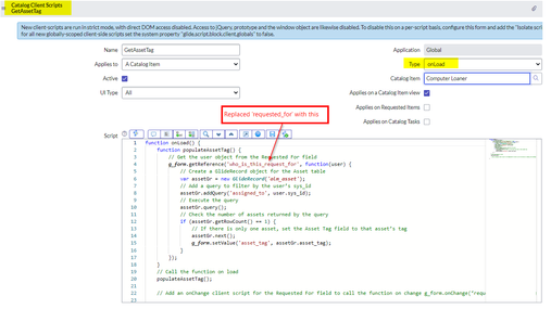

Hi @SwarnadeepNandy
I'm still trying to get it to works.
Here are the steps I have done:
1. Created an OnLoad function in the Catalog Client Scripts
2.  Pasted your suggestion code in the Script Area
3.  Replaced the "requested_for" with "who_is_this_request_for" which is Requested For type name (see below picture)
Hi Radhika,
Can you please try like this?
If your requested_for is autopopulating, then use onLoad, if its changing then use on_change client script.
Please change the variable name accordingly.
Kind Regards,
Swarnadeep Nandy
Hello @SwarnadeepNandy
Thank you for continuing helping!
1. Currently,  Miranda Hammitt has 1 asset in her possession.
2. Login as Miranda, the Asset Tag is showing blank. Since she has only 1 asset, it should populate that asset number in the Asset Tag field.
3. Here is the entire code.  Did I made a typo somewhere in the code?
Try putting console.log() statements to debug the code.
Maybe change the onLoad to onChange - field (who is this request for).
Kind Regards,
Swarnadeep Nandy
