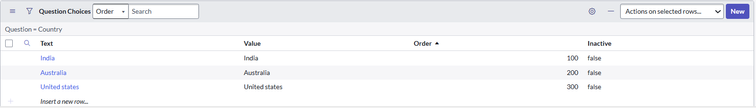

MRVS --> Variable 1 --> Country --> Select Box
Choices for Country variable as below

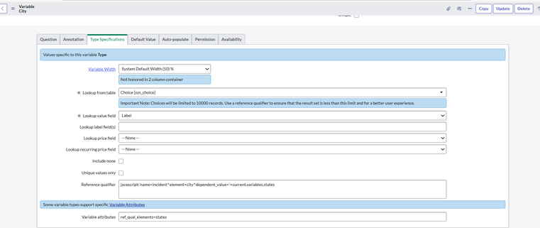

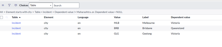

MRVS --> Variable 3 --> City --> Lookup Select Box
Choices for city for dependency value as Victoria & Queensland. If you see below Value and label is different same as per your scenario.
Below is the screenshot of variable 2 and variable 3 configuration
Variable2 --> States
Variable 3 --> City
I am keeping Lookup field value as Label for state and city variable. I can see label in state and city variable instead of values.
Compare above screenshot with your variable and check.
