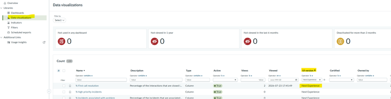

It looks like you're trying to share a regular (old-style) report on the core UI, not a data visualisation using the next experience UI.
Can you confirm if the data visualisation you opened has a "UI Version" set to "Next Experience" or "Core"? If you are opening a "Core" report, it will open in the old-style report view, with the old sharing dialog box. Only data visualisations with "Next Experience" will open in the new data-visualisation designer view with the new sharing dialog box:
