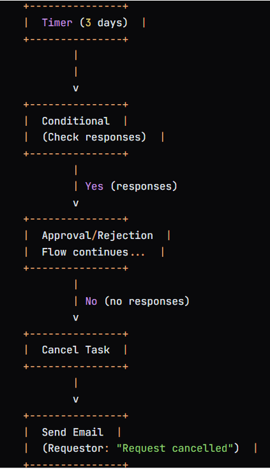

My suggestion will be use "Wait for Duration" logic within your flow to check if a task was approved, rejected,
Diagram to make you understand

If I understood your requirement clearly, you want to have a timer on the Approval Task. If yes, in the Ask for Approval Action, you can configure Due Date field to Either Approve/Reject/Cancel the Approval Task after a specific or relative amount of time.

I think this is something you will be using more often, so I would create a subflow for it. Within that subflow you set the 'wait for x time' and then do a check to see if there has been a response or not. Depending on your requirements (looking at re-useability), you can either send back a response to your main flow to create the emails and do stuff with your item, or handle that within the subflow and just send a signal back to the main flow to cancel the approvals.

@marrikruthi You can use wait for duration flow logic within your flow and wait for a certain duration to check if the task was approved/rejected or if no action was taken please refer to https://docs.servicenow.com/bundle/xanadu-build-workflows/page/administer/flow-designer/concept/flow... to know more about the same.
