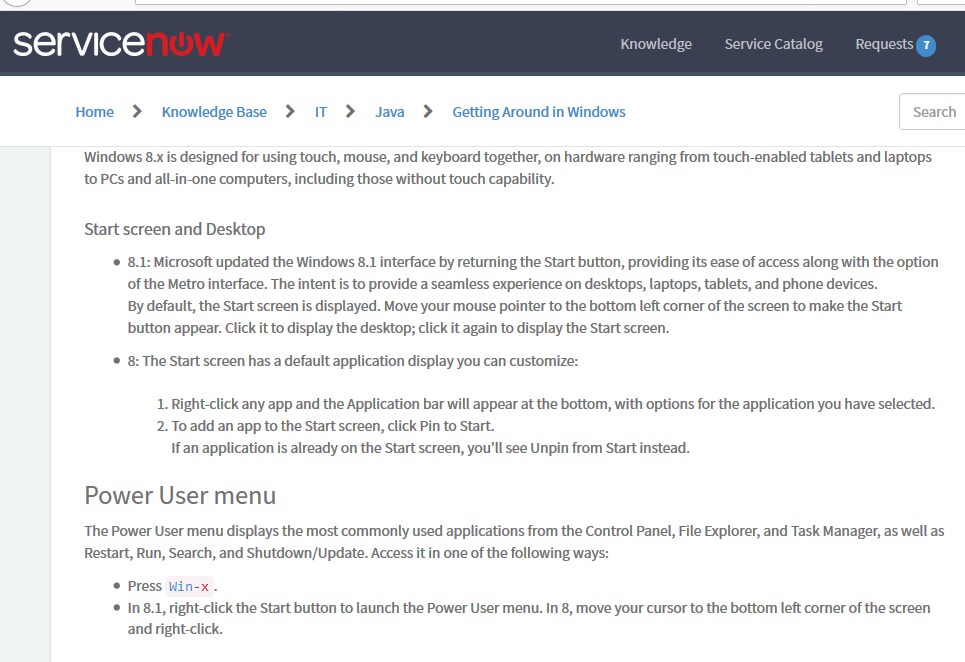

What version of servicenow are you on ? I tried in kingston and istanbul and when I click on knowledge article it takes me to the service portal view of the knowledge article record.
as shown in screenshot below.

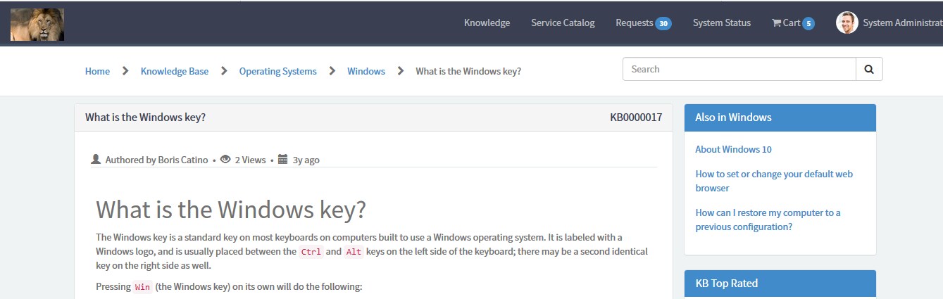

Its not happening in the KB article. KB article gets open up in the portal as shown below
Problem takes place , when I click any of the hyperlink ,related links. Related links also contain KB articles only. But when I click any of the hyperlink in the related link , it takes me to the kb_view page rather redirecting it to sp , page.

Oh I see.. The reason its happening is cos the related links have a hardcoded reference to the kb_view.do page it should be to the kb_article page I found an example at my end where there is a link in the article that points to another article, below is the text in the article
and this is the html code.. now we need to change this to point to service portal
new code
<li>Press <code><a href="/sp?id=kb_article&sys_id=3b07857187032100deddb882a2e3ec20"
The end result would be, when I click on win-x it takes me to the article and shows in service portal view
But bear in mind that this change impacts everywhere, as in even if the article is opened from the non service portal view in the first place it still redirects to service portal to view the secondary article when clicked on the link.
