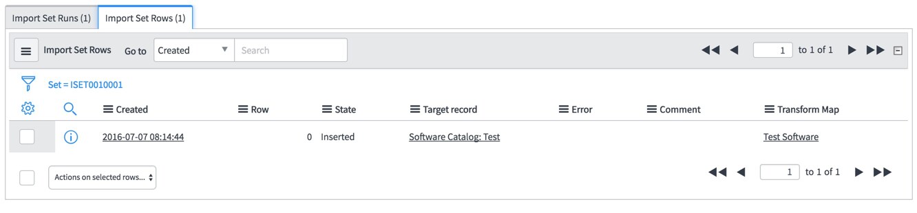

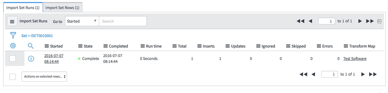

If you go to System Import Sets> Import Sets, you can find the "staging table" where your data was brought in along with the stats of what happened to it. Open the record and at the bottom you can see what happened while the transform ran and a second related list with each of the rows and what they did.
This is from an EXTREMELY limited import set, but you get the idea.

This is incredibly helpful! However... it doesnt show me the ignored records from the import. So my xls file has 65534 records and SN via this method only reports a total of 65530.
Still gives me an incredibly helpful amount of information, which im sure Ill use in the future, but doesnt show the ignored records from the import (kinda makes sense). Any other thoughts?
