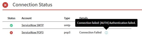

Email Diagnostics module is telling me that i can't receive Emails because of an authentication error.

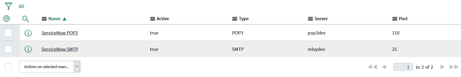

I don't know if something is wrong with the default Email accounts, but i didn't change their configuration at all.
I checked Email configuration as well, but i don't think they're wrong. I only changed the enable sending/receiving options to yes.

CHeck the below link here it has been given a way to test POP3 connection.
https://docs.servicenow.com/bundle/orlando-servicenow-platform/page/administer/reference-pages/task/...
