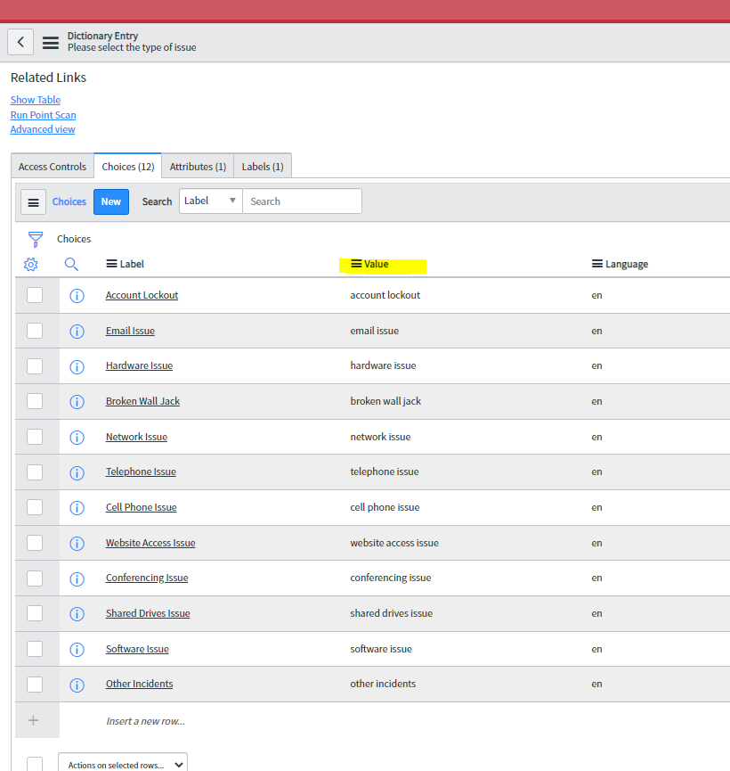

I have created a custom field named " Type of issue:  on the incident form " string"  and then created choices ( have 12 choices).
Then I created a select box variable  on the "Create an incident" item and added the ( same 12 choices). The value on the incident form and catalog variable are exact same.
Then I mapped the fields in the incident variable
The values wont match, rather it creates a new entry ( screenshot below)

In the mapping, you are using db value? If yes, can you use db value a d map.
If done already can you check additional space is available for the new value compare it existing one.

When you say DB value are you talking about this?

There is also a checkbox on mapping for "don't create if exists", I think that would fix the problem.
