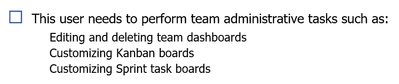

I am creating a new Catalog Item to display on our Service Portal.  The process owner wants a check box that looks something like this:
The problem is that the Check Box Variable does NOT have any Instructions or Help Text annotations which you can add.  The best I could do was to add a Rich Text Label after the check box field, but it is pretty ugly and too spaced out:
Does anyone have a better solution to this?
