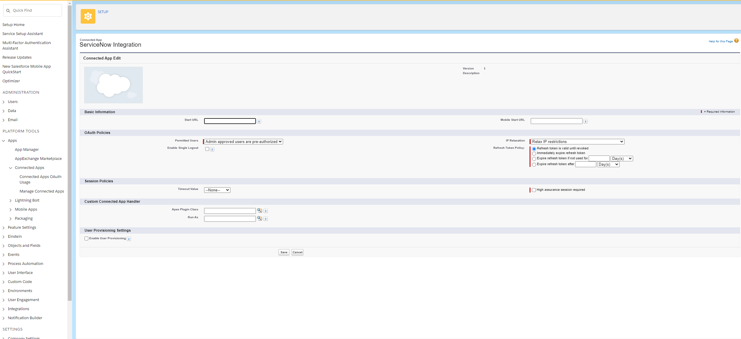

Unfortunately, I got stuck on this point - Create credential records for the Salesforce spoke. When trying to get OAuth Token I get the following message:
OAuth flow failed. Verify the configurations and try again. Error detail: invalid_grant, user hasn't approved this consumer
Has anyone encountered a similar problem? Below I am attaching screenshots from SN and Salesforce instances. Maybe you'll see something that I can't
Salesforce Connected App
Salesforce OAuth Policies
SN Certificate
SN JWT Key
SN JWT Provider
SN Application Registers
SN OAuth Profile
SN OAuth Credentials
Maybe some of you know a way to check where the error is?
